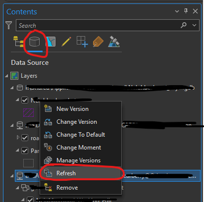

I found another option to the refresh problem.  I am creating a Task  to edit data.  The task uses several python script tools.  To refresh the data, I use the Refresh command that is found when you activate the Data Source tab.  I added a step at the end of my Task to call this Refresh command, that seemed to do the trick.  I used the Record function in the Task Designer to add the command.
I know its not a perfect solution, but it's something if you are using a Task, it seems to do the trick.

I'm running a python script from a toolbox tool (ArcGIS Pro 3.3.0) and it still doesn't refresh the attribute table.  Nothing seems to except refreshing from Data Source > Refresh  on the Contents pane. My data is in an enterprise geodatabase (sql server) and versioned using traditional versioning. I'm also using the new arcpy.RefreshLayer() command that came in with 3.3.0 but that does nothing.  I suspect because it's on a versioned feature class.
This is just super annoying - I just want an arcpy command that does the same as Data Source > Refresh.
