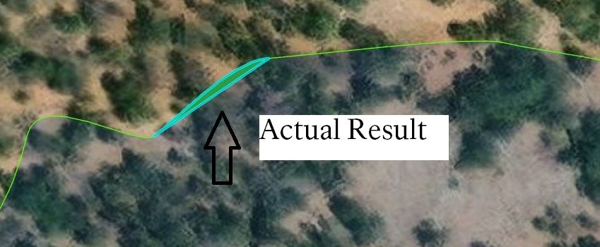

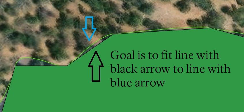

Hello I am using ArcGIS Pro 3.2.2 and having issues with the Reshape tool. I have to reshape sections of large polygons to match smoothed curves. Sometimes this works as expected, but there are certain curves where if I use the Reshape tool it will shrink the polygon dramatically. I have "Choose result on finish" selected but it does not give me options when this happens. The layer is not being projected on the fly.
For a scale of the issue, I am currently working on a 182-acre polygon. I trace an 87 foot long segment to reshape and it collapses the polygon down to a 269 square foot polygon that aligns with the traced curve.
How can I make ArcGIS expand my polygon, not shrink it?
Thank you for any advice!
(The first image is what I am trying to do. The second is the result ArcGIS is giving me using the Reshape tool.)

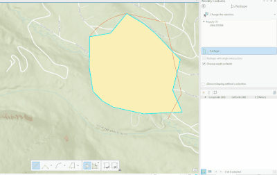

@JohnFaab01  With the 'Choose result on finish' option checked, you should be able to see a dashed-grey line over the two parts of the feature you are reshaping (see GIF). For your case, once this dashed line appears, move your cursor over to the larger portion of the polygon then click once to apply the edit i.e. to choose the larger portion as the result to keep. As @DanPatterson pointed out, when 'Choose result on finish' is checked, you have to make the decision yourself which part to keep when reshaping, otherwise uncheck the option to always keep the large portion when reshaping.
Here are some high level steps for the workflow:
1. Select the polygon to reshape and open Reshape tool. make sure 'Choose result on finish option is checked.
2. Trace the (line) feature you would like to use to Reshape
3. On the Editing toolbar at the bottom of the map, click Finish (I recommend this option over double-clicking in space to avoid applying the edit inadvertently). Dashed lines should appear indicating the options to choose to finish your reshape operation with. Move the cursor between one of the smaller parts and the other single large part  and note how the dashed line moves over based on where the cursor is.
4. Make sure your cursor is on the large polygon shape and then click once to complete the reshape operation.
I hope this helps.
