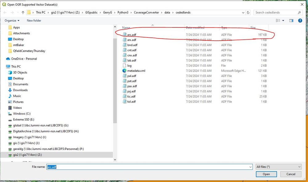

I had to revive a project from 20 years ago and the data were coverage files.  QGIS can still convert coverages to file formats that ArcGIS Pro can read.  Just add the correct file when adding vector data.  You might find more help here.  https://gis.stackexchange.com/questions/211315/open-arcinfo-files-in-qgis
