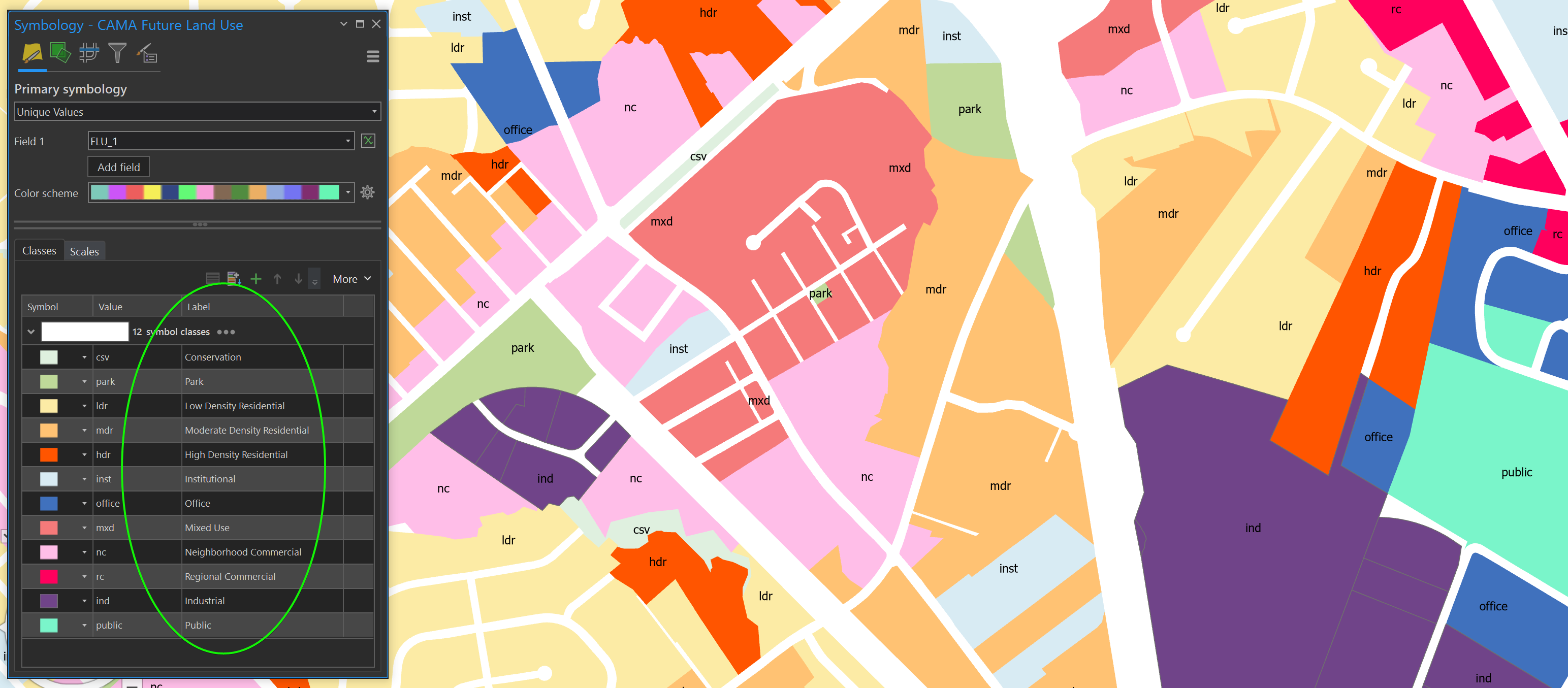

Hello all.   I am trying to label some polygon features based on the label value in the symbology window and not the "value" field but despite my attempts at changing settings in between maplex and standard label option, I have been unable to resolve the issue.  I'm still kind of newish to Pro so there is definitely a learning curve.  I like how ArcMap automatically labels by that "label" value from the symbology window or even how they are manually typed in the table of contents.

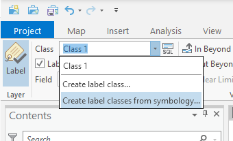

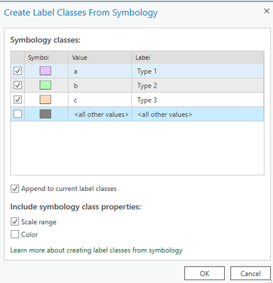

Suppose you have manually configured aliases instead of a domain, it would be nice to be able to translate your symbology directly over to labels without much fuss. There is a method of converting symbology classes to label classes, of course:
Which is nice for certain situations, but then each label class has to be manually configured, which might be more work than just writing a decent label expression in Arcade. If you used a Where or a Decode, you could actually have the same expression being used for both symbology and labelling, and you could just copy and paste the expression in each.
var adhoc_domain = {
    'inst': 'Institutional',
    'hdr': 'High Density Residential',
    'mdr': 'Medium Density Residential'
    // and so on
return adhoc_domain[$feature['FLU_1']]
In general though, if there's a value or alias that's going to be useful in more than one spot, it ought to be in the data either as a field or a domain. Relying on ad-hoc definitions and typing your labels in seems like it would take up more of your time.

Thank you so much for your feedback!  I was able to use your expression example and get the labeling that I wanted.  I am brand spanking new to Arcade and really need to start trying to use it more.  I've not ever been more than a simple statement writer so I guess I better get practicing.  😋
