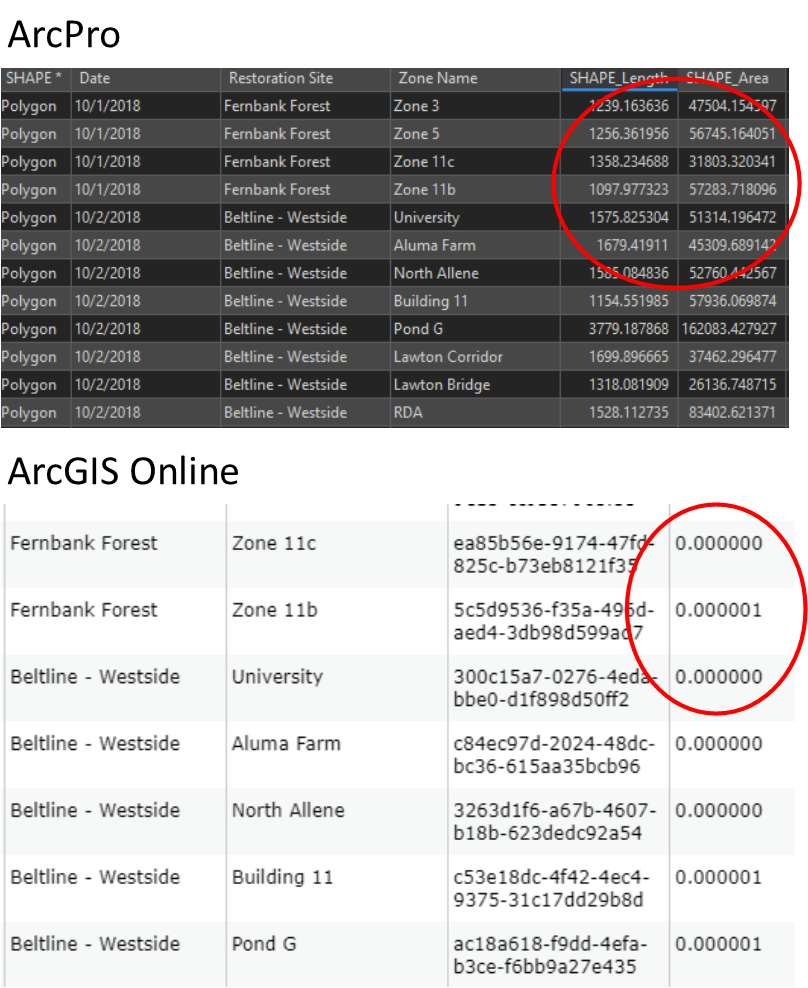

I have been attempting to publish a group layer to AGOL and keep the set projected coordinate system from changing to Web Mercator and cannot for the life of me figure this out. I've done it before on ArcMap, but the process is not working this time around and I'm very frustrated. The layer in question is a grouped feature layer with lines, polygons, and points. The zone polygon layer is the one I'm most concerned about. We'll look at the shape area to build pricing models, estimate time needed to complete, run analysis, etc.
The big issue is that pushing the layer to AGOL (which is essential for us), changed to set projection from "NAD 1983 StatePlane Georgia West FIPS 1002 (US Feet)", to "WGS 1984 Web Mercator (auxiliary sphere)". I understand that this is the default projection for AGOL, but if I specify that I want StatePlane as the projection, why does it keep overriding me? WGS 1984 Web Mercator (auxiliary sphere) is useless to us as we need to easily see those measurements in feet, not esriDecimalDegrees.

Unfortunately, each time I run these processes, the units are fine in ArcMap and Pro, then default back to esridecimaldegrees on AGOL.
How can I go about locking that original set projection when sending layer online? Many of our coordinators solely use AGOL and don't get into Pro, so we would need to have the value reflect properly for them to use.

Make sure that the map that contains the layer you are publishing in ArcGIS Pro has the same SR as the desired SR in AGOL/Portal.  The layer will inherit the SR of the map when published regardless of the layer's SR.
If I had to guess, in ArcGIS Pro your map's SR is Web Mercator (the default)... while the layer you are publishing is in StatePlane.  When you publish your data, it is reprojected to use the map's SR... in this case Web Mercator.
Instead, set your map's SR to StatePlane and optionally set your layer's SR to the same StatePlane.  When you publish, the layer's SR will be StatePlane.  You can check the service url to confirm the SR of the layer.
