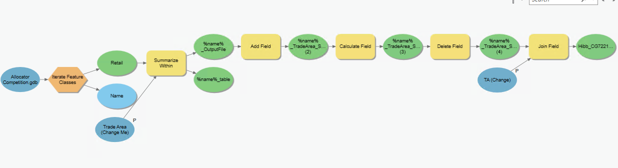

Hello:
I created the below model that would provide an overall summary count of points within a buffer. While this works, I’m now being asked to breakout the total number of points by name (for example, 5 Walmart, 9 Target, 12 Best Buy, etc.).  I’m hung up how to modify the model to automatically add a new column for every / each name and then sum / count its number points within that buffer.  Any suggestions would really be appreciated – thanks!

could you add
Summary Statistics (Analysis)—ArcGIS Pro | Documentation
to your workflow

CraigHarris1
Thanks! For the model I have posted, where would I add Summary Statistics? (I'm new to ModelBuilder). 🙂
DanPatterson
MVP Esteemed Contributor
I don't use it period... but you would put it and connect it in the place after you have gathered the input data you want to summarize.  So what output do you want to summarize?

CraigHarris1
I have a point layer of retailers.  I want a column for each store name and a count of how many stores they have within a polygon layer.
