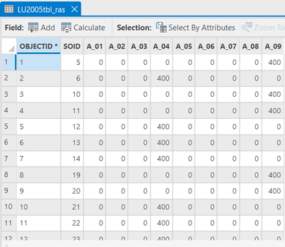

The table after "Tabulated" looks like:
Table after tabulatedTable after tabulated

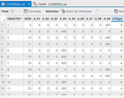

The result I want:
The result I wantThe result I want
