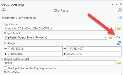

But, download the zip file, unzip it, load the unzipped tif file into Pro, then use the Clip Raster GP tool to clip out the area of interest.
For the output extent, you can click on the pencil and select Polygons, and it will create a new polygon layer that you can edit and sketch the area of interest and run the tool.
