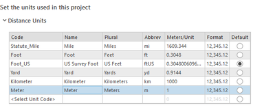

They are set at the project level.
What are yours set to?  and see if changes persist within the project.

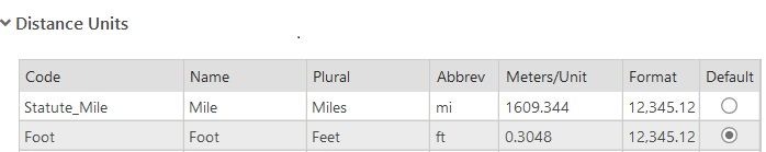

JimmyKroon
I had already tried that, here are my settings. It isn't affecting the measure tool.
DanPatterson_Retired
MVP Emeritus
I am using ArcGIS Pro 2.5 (beta).
Maybe they fixed it, I have my units set to metric.  I switched the tool to measure in miles, made a few measurements, closed the tool.  I reopened the tool and the measure tool was still set to miles, so I set it back to metric... closed the tool, reopened it and it was metric
MVP Emeritus
The first image was for project specific as yours, and within project seems to work.  What doesn't seem to work for 2.4.3 is keeping it set to imperial units after the project is closed.  Which makes me wonder if your data units are metric to begin with and the default setting is to the units of the data first, then desired units second.  I can't check since I only work with metric data.

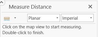

DeanAnderson2
This problem appears to be back in 2.6 and 2.8 ArcPro.  The default is ALWAYS imperial.  The options--> Units-->Distance Units dos not change the default.  I have it set to Feet as the option and the following happens...
Am I missing something??
Ronald_Coker
I'm having the same issue where I set the Distance Units in Options, but the Measure Distance tool always defaults to Imperial.
