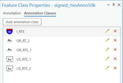

So unfortunately I don't know where the original data came from so I can't recreate it from the feature class as I said in my original post. Thankfully I was able to figure it out, you actually access it from within the GeoDatabase in Catalog instead of the Content. This actually make more sense because that settings is shared at the geodatabase level, the actual ArcGIS Project doesnt contain that data. You can just bring in that annotation layer and it will have the same templates everywhere and saves on one project will be translated to all projects that use the data.
  1. Right click the Annotation Feature Class within the GeoDatabase
  2. Select "Annotation Feature Class Properties"
  3. In the new pane select "Annotation Classes"
  4. Click pencil icon to edit individual Annotation Classes:ccowin_odfw_0-1683916076574.pngccowin_odfw_0-1683916076574.png

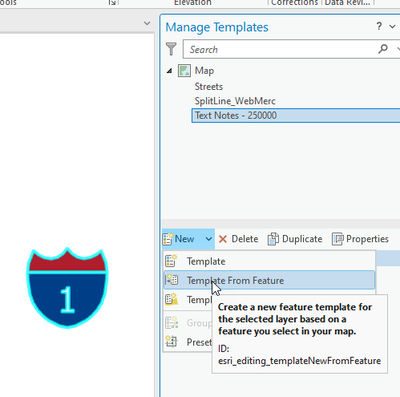

@ccowin_odfw Try this:
  1. Select an existing annotation feature that has the symbol you want.
  2. Open Manage Templates > New > click Template From Feature Scott_Harris_0-1683661909850.pngScott_Harris_0-1683661909850.png
  3. From the template properties dialog, you can modify the annotation's text if you want, give it a name, etc. > click OK
  4. When you go to use the new template, it may look like there's a problem with the template - giving a warning about a bad symbol attribute (I'm actually not sure why this is quite yet) - but the template should  work to create new annotation features using the desired symbol.
Scott_Harris
That makes sense. I assumed you the meant feature templates used for creating annotations, and not referring to the annotation class itself. Thanks for closing the loop.
