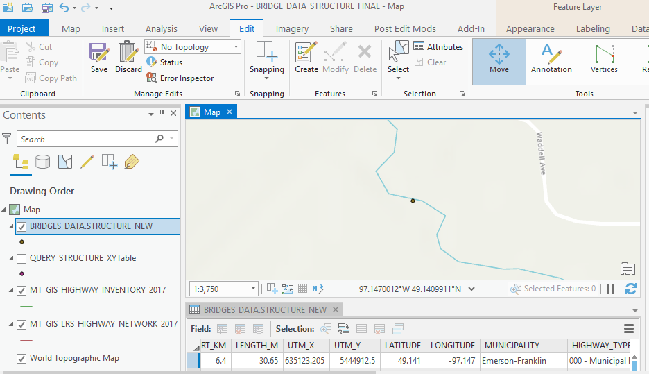

Created a QueryLayer
On selecting a particular attribute on Map and select Edit Ribbon and Click Modify and then select Move
I am unable to move the point to a different Coordinate:
Where as on a File Geodatabase, I can Modify and click Move and Change the Co-ordinates.
Only on an Query Layer which was connected to enterprise GeoDatabase, I am unable to do it.
