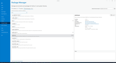

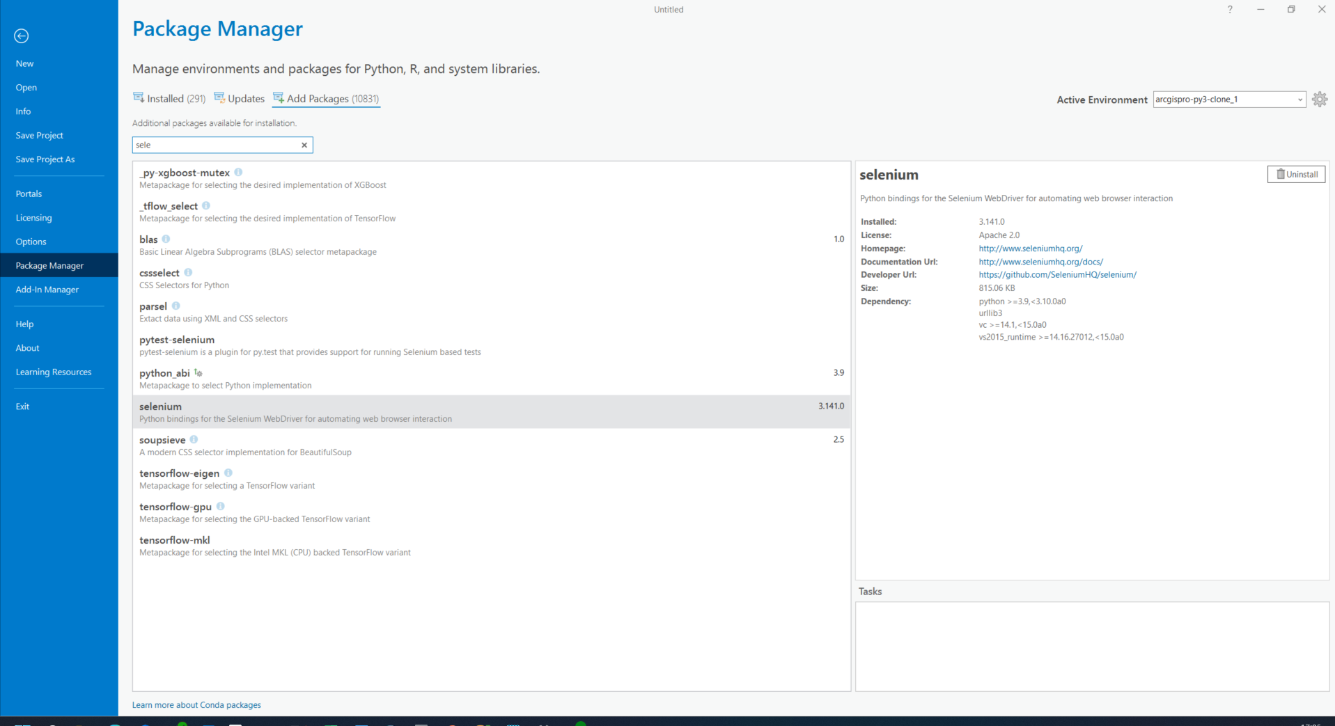

Hello,
Is there a way one can download packages that are not within the Esri package manager?
For example, I want to download the latest version of selenium. According to the package manager, this installed version is 3.141, which is miles behind the current version I would like (4.21.0)
when I try and download selenium through the python command prompt: conda install -c esri selenium I get the same issue. Which is obvious since it is doing the above, just through the command prompt.
So I am wondering how I can download packages etc. that are not within this Esri library . Ideally I would like to avoid using pip because I am trying to get other people to download things on their machines, so the less steps they have to download the better. But I understand if that is not possible. Thanks!

conda install  -c defaults selenium
conda install selenium --no-pin
didn't work, so that leaves
conda-forge/selenium-feedstock: A conda-smithy repository for selenium. (github.com)
which is going to be complicated for the casual user, leaving you to decide whether the current version is really necessary or to decide whether "newer must be better"
