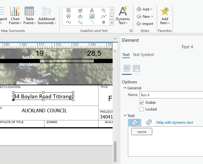

In ArcGIS Pro Map Series, I am using dynamic text from a table for my map series "Page Name".  In the "fields" of the table the line I am using is Data Type "text". It is shown in a single line.  Is there any way to make the single line behave as a multi-line text in the Element editing for when the text becomes too long for the space provided in my title block?

If you add the dynamic text as rectangle text it should automatically wrap. You can read more here: Word Wrap in Dynamic Text for Layout (esri.com)

Fantastic, such a simple little "thing to do" before selecting dynamic text and there you have word wrapping.  Thanks so much for taking the time to respond.  Much appreciated.
