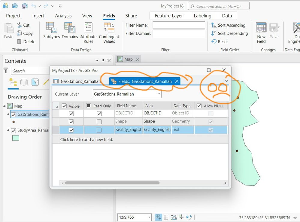

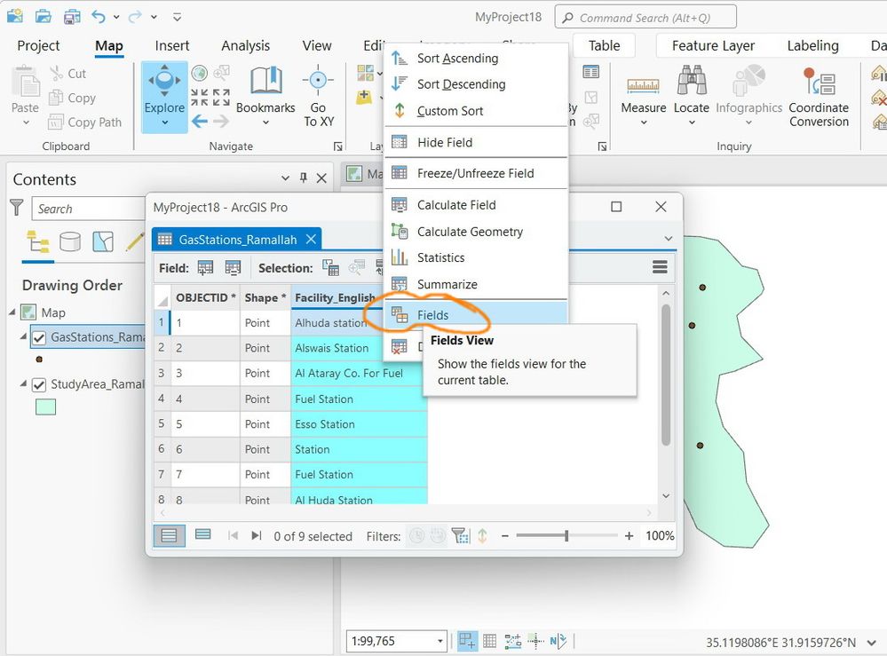

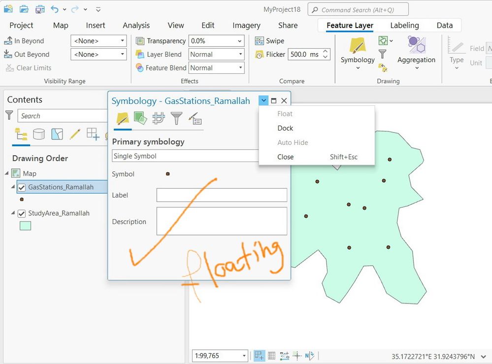

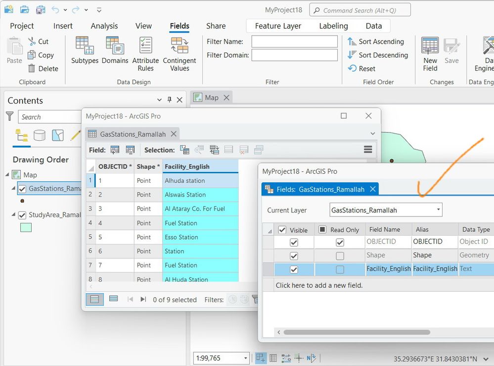

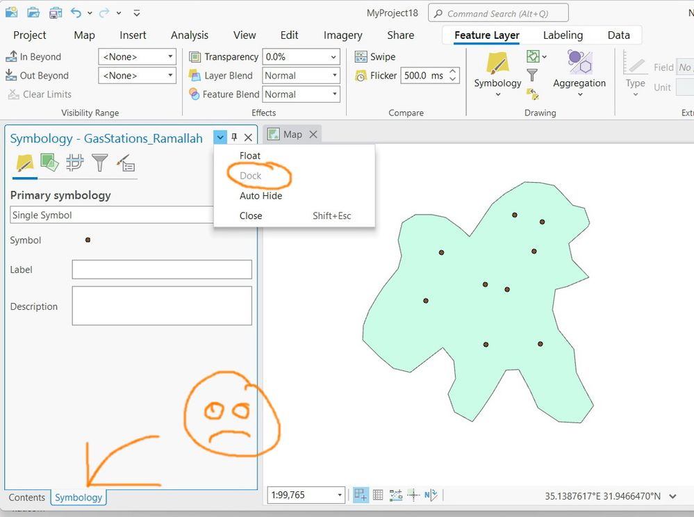

where is this option available? Does it undock all panes automatically as they get started?
https://community.esri.com/t5/arcgis-pro-questions/arcgis-pro-2-8-4-how-to-get-the-as-a-separate/td-...
