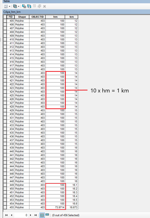

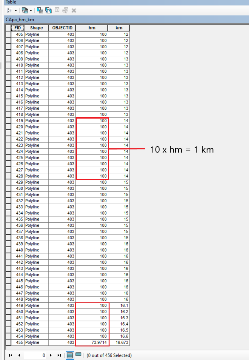

Hello everyone,
I need some help with a python code to populate a field with sequential numbers based on the count of another field in attribute table with field calculator. Like in the image, 10 x hm correspond to 1 km, but when count of hm <10 i need to summarize the last km with the values from hm field.
Any suggestions?
Thank you in advance!
ArcMap 10.8.1
