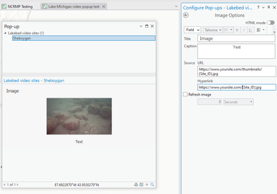

You can specify the field in the URL (this shows the picture in the popup) and the Hyperlink (this opens a new window).
Here's an example that uses a thumbnail in the popup for a fast draw, but a full-size image for the new window. Each site has a unique photo.

That's the field, which contains a value like "AA2017_258", which is part of the url of the photo. I made a fake one in the image I sent, but the working version of the string in the hyperlink field looks like this: "https://www.nodc.noaa.gov/archive/arc0166/0222391/2.2/data/0-data/LakeMichigan_2017_2018_Videos_Photos/Photos/{Site_ID}_1.png" while the URL uses this for the thumbnail: "https://www.nodc.noaa.gov/archive/arc0166/0222391/2.2/data/0-data/LakeMichigan_2017_2018_Videos_Photos/Photos/thumbnails/{Site_ID}_1.png"
What would be an example of a URL for you and what field would hold the unique part of it?

How do you link a feature to an image? Is there a field in the country layer that contains the URL for each country?
ToniBisig
Sorry for the late reply. I did indeed add a field which has a different URL for each country. Then in the configure pop ups pane it looked like this. That way, anytime a feature is identified, a different image comes up depending on the country that was clicked on. Appreciate your help!
