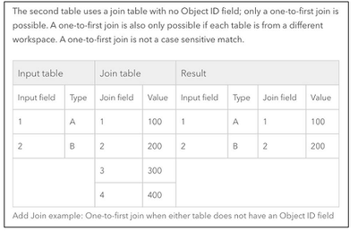

Add Join (Data Management)
The second table uses a join table with no Object ID field; only a one-to-first join is possible. A one-to-first join is also only possible if each table is from a different workspace. A one-to-first join is not a case sensitive match.
Records from the join table can be matched to more than one record if the join table has an Object ID field; otherwise, a one-to-first join will be performed.
AKRRMapGuy
Both tables have Object IDs.
