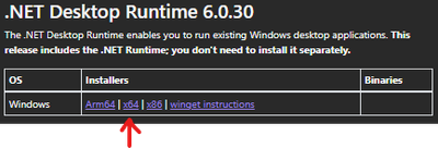

You need to download the matching windowsdesktop-runtime-6.0.xx-win-x64.exe from Microsoft at https://dotnet.microsoft.com/en-us/download/dotnet/6.0.  For windows 64-bit ArcGIS Pro 3.2.x or older it it is the following:

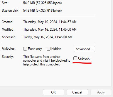

Once you download it make sure to "Unblock" the file in the file properties if needed.

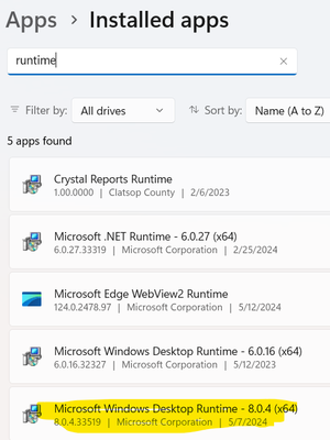

Sorry, this is the heart of the matter, it's not that one at all and you probably have different versions installed to support different apps so it's not a matter of just replacing version 6 with version 8. IT IS CONFUSING.
Open "Apps" control panel and search "Runtime" not ".NET" like I did earlier!! For Pro version 3.3 you have to have the runtime version 8 and it's called "Windows Desktop Runtime" not .NET but when you DOWNLOAD it, it's called ".NET Desktop Runtime" and you need the version with DESKTOP in its name.
