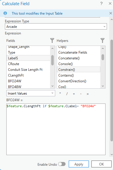

I'm attempting to use Arcade to populate the length from a different field to a new field but only if that length corresponds to a certain label I have attributed in another different field.
The expression I have above does not work 😞

Here is an article that will help you understand If statements a little better. Your current statement is just formatted incorrectly. It should read something like this:
If($feature.Clabel == "BFO24W"){
return $feature.ClengthFt

THANK YOU SO MUCH!! That worked perfectly! and thank you so much for the helpful link, hopefully someday I'll understand these expressions 😅
