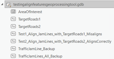

In troubleshooting this issue, it seems that the spatial index grid size might have some effect on the alignment results.  Somewhat by accident, I noticed that if I take the same input geometries, and align them with the same target geometries (repeating the test using target feature classes with different spatial index grid sizes), one resulted in a correct alignment and the other did not.   I repeated the test in ArcGIS Pro 3.1 and in ArcMap 10.8.2 and I get the same results.
Can anyone help me figure out how to achieve the best results from the Align Features tool?  Would using a larger or smaller grid size help, or is it completely coincidental?

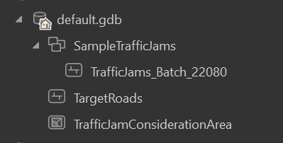

Dan, did the new ArcGIS Pro package attachment (SampleRoadsAndTrafficJams.ppkx) that I posted today come through?  That one has more batches of jams as well as the complete set of target roads.

Yes, I extracted the ppkx you shared.  Here are the data I got:
DavidSchuster
Strange, I'm reattaching the new ppkx file to this post.  It should look like this:
DanLee
by Esri Regular Contributor
Got it right this time. Thx!
DavidSchuster
Thanks Dan - btw, I'm sorry, the project only has one batch of jams (I thought there were more batches), but it should be plenty to give you the idea of the type of geometry we're getting for the traffic jams.
