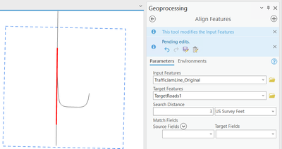

I've attached a sample project and some images showing the issue.  For simplicity, I eliminated all the roads and traffic jams except for the ones I'm testing the problem with.
The black lines represent a straight section of a service road, and a turnaround section that forks off of the service road.  These are the target geometries I'm trying to align a traffic jam to.  There are two versions of this target roads feature class.  The geometry in both is identical - the only difference between the two feature classes that I can find seems to be the spatial index grid size.  "TargetRoads1" has a grid size of 760ft.  "TargetRoads2" has a grid size of 980ft.  The input lines feature class has a grid size of 2600ft.
The red line represents the traffic jam that we are trying to align to the target roads.  Visually, you can see that the jam should line up with the straight section of the service road.  When aligning against "TargetRoads2", the Align Features tool gets it right (green line).  But when aligning against "TargetRoads1" it gets it wrong (orange line) - the jam aligns briefly to a section of the turnaround, and then jumps back to the straight section of the service road.  (p.s. I used an align distance of 20 ft for all of my tests)

I tested Align Features; it worked for me without setting spatial index grid size.
DavidSchuster
Although 3ft search distance works, you'll see the problem again if you try a search distance of 5ft.  And unfortunately in my case I can't make the search distance too small because the traffic jams lines are coming from a completely different provider.  Some of the jams are off by as many as 10 feet, sometimes more.

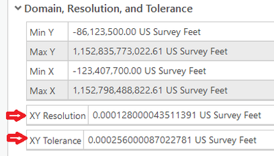

By the way, I noticed that your TrafficJamLine_Original has the standard xy resolution which is 1/10 of the xy tolernce, but TargetRoads1 has non-standard xy resolution and xy tolerance. I am not sure if it would make a difference in what you are trying to do, but it may potentially cause invisible problems or bad result in your workflow.
You can try the following:
- Use Create Feature Class to create a new empty feature class using TargetRoads1 as the Template Dataset and TrafficJamLine_Original for the Coordinate System.
- Use Append to add all features from TargetRoads1 to the new feature class.

My suggestion on creating a new fc and appending the original features into the new fc was to get the data in a standard stage, so the XY Resolution and XY Tolerance for your data would be as shown below. I didn't think this would resolve the Align Features problem, but it would ensure data integrity for analysis down the road.
