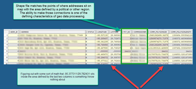

How does the computer figure this out?  There must be a certain math involved,  no?
This was not taught in any school I ever attended.
ChristopherCounsell
MVP Frequent Contributor
Vector data typically consists of:
  • Geometry (points, or points making up lines/polygons)
  • Attribute data (table where each geometry record has associated valeus)
You are showing a table. Taking a guess:
  1. Addresses were geocoded (a location service provider translated an address to a point)
  2. The points have a latitude and longitude value; geometry
  3. A geoprocessing tool identified where these points intersected with polygons (political regions)
  4. The table shows the combined attribute table where a point matched a polygon.
First things:
  • Status of 'U' means that the address was unmatched; no latitude calculated
  • The 'COMM_POLYGONSIZE and COMM_POLUYGONLENTH fields are likely attribute data showing the actual area/size of the polygon. They aren't used in step 3. It's not coordinate-based geometry.
How does it do it? Geoprocessing. Coordinate Systems, geometry-based calculations. Possibly projections and datum transformations. It's not likely to be clean math that can be shown in a table. e.g. here's a couple of tools:
https://pro.arcgis.com/en/pro-app/3.1/tool-reference/analysis/spatial-join.htm
https://pro.arcgis.com/en/pro-app/3.1/tool-reference/analysis/intersect.htm
