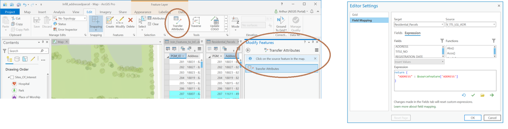

Hi there, Is this the Transfer Attribute Tool to which you were referring?  To copy the attributes from one layer over to another?
Can you only transfer the attributes from 1 feature at  a time?  It says to click on the source feature in the map.  Is there any way to click multiple features from the source layer?
