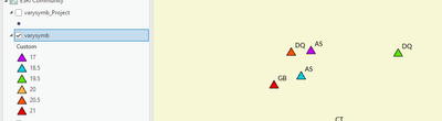

For example, you could just use the arcade you have now to set the available ranges, then change the symbols of the points to triangles:

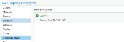

Then if you only wanted some of the sensor types, you could use a definition query to only include the values you need:

Sure, okay so I don't really know exactly what the different sensor types are, but another option would be to copy the layer by right clicking it in the table of contents, and pasting it there so you have two of the same layer. Then you can switch the definition query of your new layer to be the opposite (ie. show only AS and CT) and change those symbols to circles:
Then, to make your legend easier to manage in the layout, you can change the Label value in the symbology pane (mine will look different than yours because you have more values in your CSV but you see the idea):
Then you go ahead and add a legend to your layout and there will be two legend items, one for each layer (and therefore groups of sensors).
