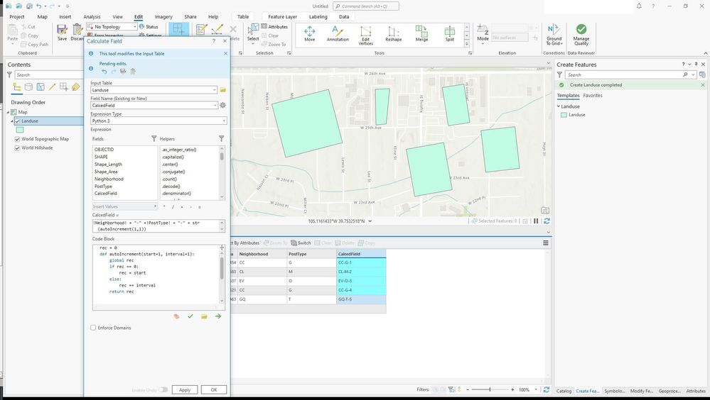

@AydanScottDSDP  - so I've been messing around with some Python code blocks in the Field Calculator and I'm getting close.  The only thing not working is the sequential numeric values for each Neighborhood/PostType combo if you don't select any features.  Instead of CC-G-1 and CC-G-2, it just goes 1-N for all Neighborhood values.  I think if you selected features based upon neighborhood, THEN run the Field Calculation GP tool, it would work fine/as expected.
The key to the field calculator is the sample scripts that come with the ArcGIS Pro help - Calculate Field Python examples—ArcGIS Pro | Documentation - I used the Accumulative and sequential calculations.
See my image below:
AydanScottDSDP
@Robert_LeClair  - That's about as far as I've been able to get as well. I have also been playing around with various ideas. I'm sure there is a way, but I have yet to find it.
