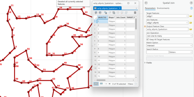

one polygon, many points
target the polygon, with keep all target features results in many polygons... all duplicates of the initial one.
before you start playing around with your data, experiment with a simple case so you don't inadvertantly end up with duplicates that you don't want.
Reversing the direction?  of course you can continue with my simple example to see what happens
