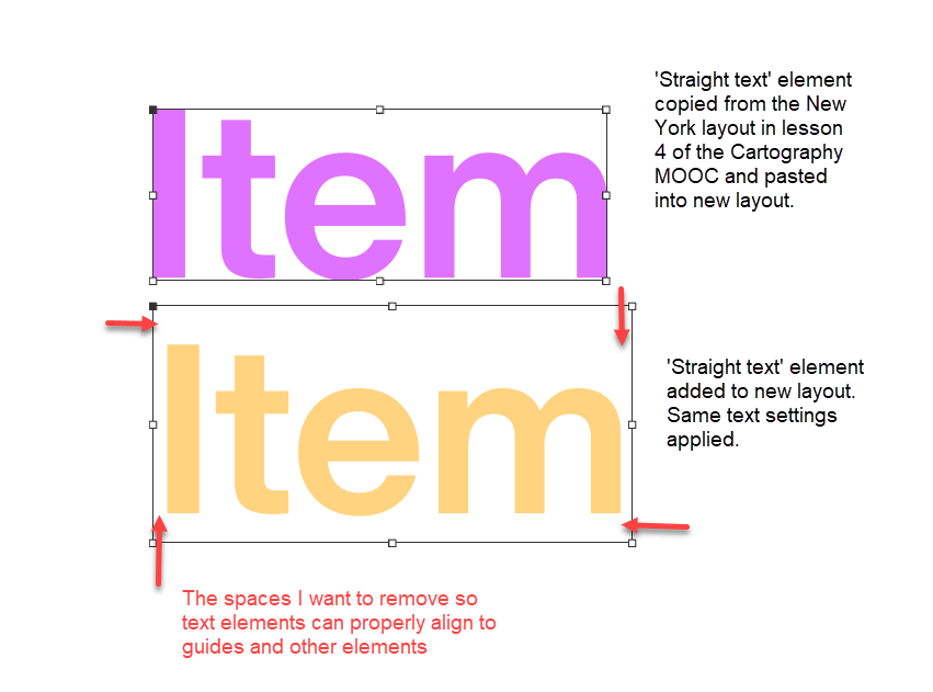

The text elements in lesson 4, exercise 1 of the Cartography. MOOC are formatted without this space/padding and is what I am trying to achieve.
I have copied and pasted this into my new working layout to determine how it has been configured, however, there appears to be no setting for this.
When I create a new text element in my new working layout, matching all of the text settings between it and the copy from the Cartography MOOC, the space still appears.
Following the methodology in this video, which uses a rectangle text element, did not work either. The text elements still have space.
Screenshot of layout text element with unwanted space/padding

I requested a case with ESRI technical support about this issue. ESRI looked into it and were unable to provide a solution to remove the padding around graphic text. They responded "unfortunately there isn't a setting that will let you alter the padding." They have requested that I submit a response for their enhancement log.  I will be including this issue along with several other layout issues in my response.
