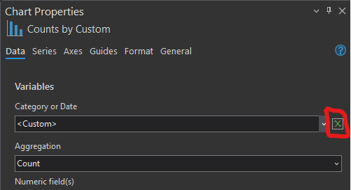

Instead of using a field as category, you can use an Arcade expression:
return IIf($feature.YourField < 0, "x < 0", "x >= 0")

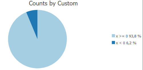

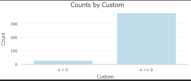

Using this, you can easily create Bar and Pie Charts:

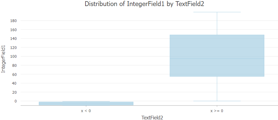

You can also use the expression to calculate a new field in your table and use that field as category field for bar/pie charts. This has the added advantage that you can also use it in other chart types. FOr example, here is a box plot of the integer values by category:
