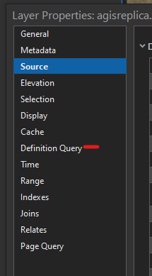

clt_cabq
If you want to display only one crop type for instance, you can add a 'definition query' where you would construct an expression that says "crop type = 'rice' " - when applied it will show only rice crops. You can copy/paste that layer then and then edit each definition query to show only the crops you want to show when a given layer is checked on. You find the definition query under the layer properties (when you right click on a layer, its the bottom most selection, then you will see the properties panel with the def query option as below:
