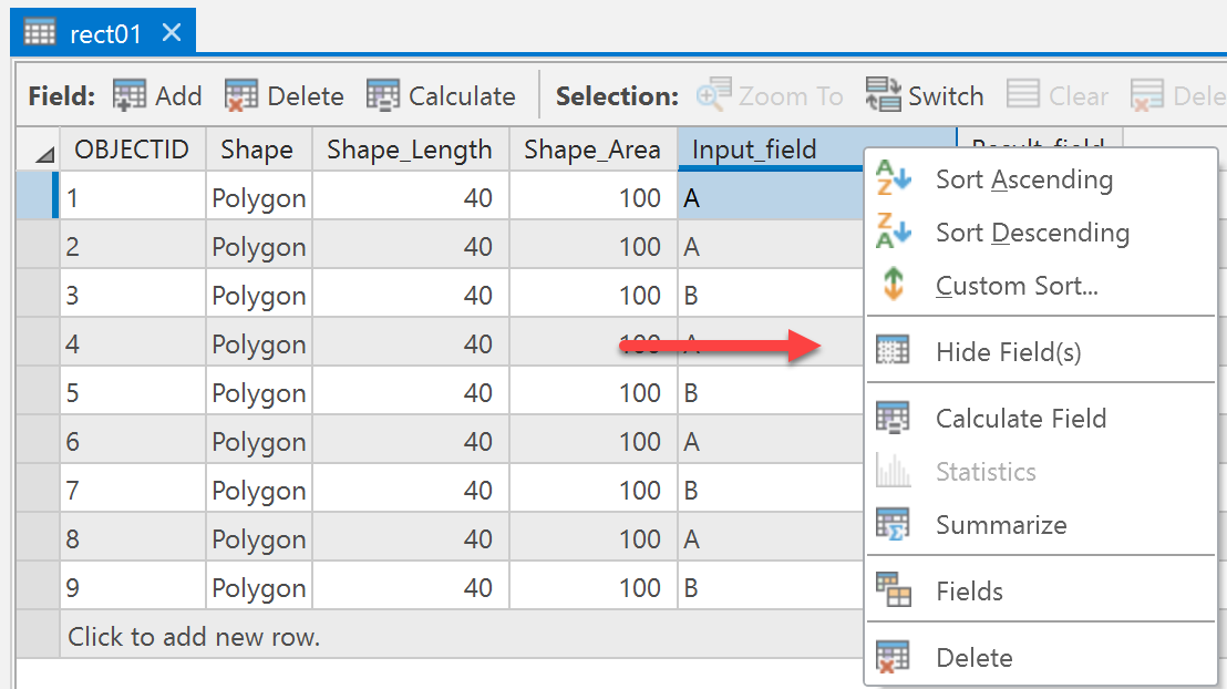

Brian  The easiest way is to right-click on a field and...

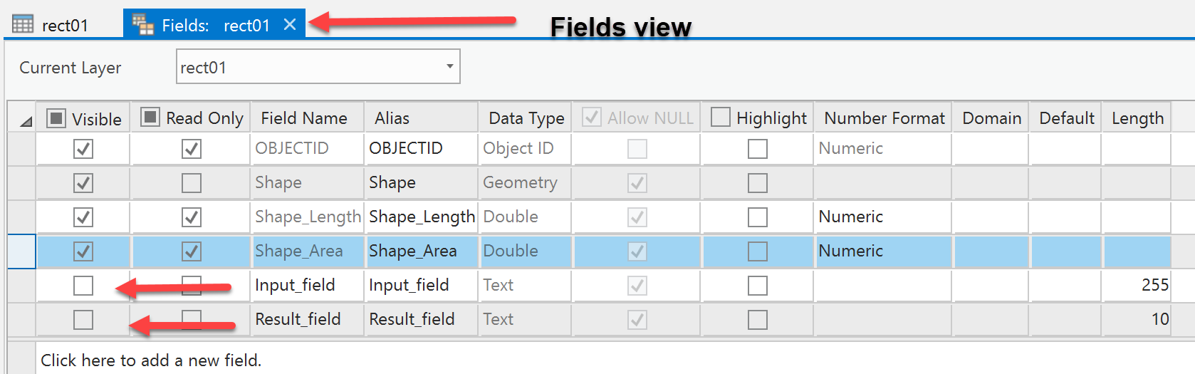

Then you could do it another way in the 'Fields View'
Then you can toggle on or off depending on the state that they are currently in

Thanks Dan. I am aware of these methods but I wanted to incorporate the Hide Fields into a task. My goals is to have  users in my group run a task and it automatically hides approx 33 out of 36 fields.
