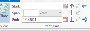

To make the display cumulative rather than point in time, you have to disable the start time of the time span. Click on the start time and end time buttons (next to the calendar date selector buttons) in the Current Time group to change them from bars to arrows.
Point in time display:
Cumulative display:
