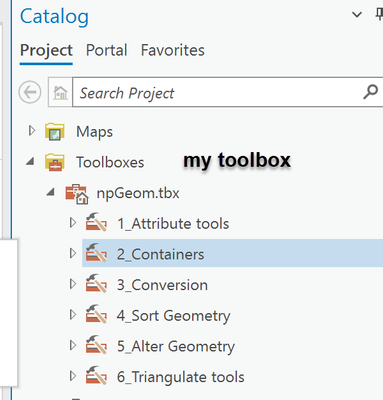

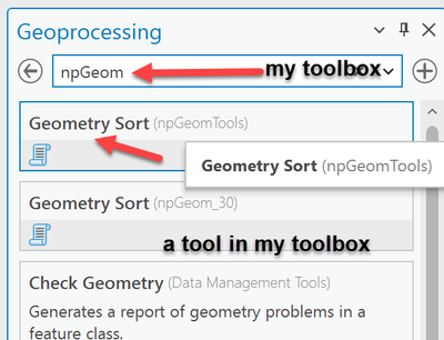

I haven't seen a custom toolbox show up in the pile of esri's tools.  You add the toolbox to your project using catalog and use it from there.  The tools are supposed to be searchable  is you have provided a non-conflicting alias to the toolbox

Don't know, but in Pro 3, I add my toolbox and I can search by toolbox name or tool name
