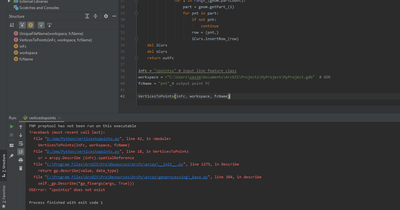

matu89
hey,
still dont work for me:
here is the data from Arcgis Pro:
what i did wrong?

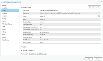

HuubZwart
The describe function fails because the path to 'zzpoints' does not exist. Note it takes it path relative to the currently active workspace: you could set the active workspace in your script before you access the feature class:
arcpy.env.workspace = r"C:\Users\sasim\Documents\ArcGIS\Projects\MyProjects\MyProject.gdb"
MicZatorsky_AEC
Exactly.  Or provide a fully qualified path to the feature class:
inFc = r"C:\Users\sasim\Documents\ArcGIS\Projects\MyProject\MyProject.gdb\zpointss" # input line feature class
matu89
thank you very much! it works !!
