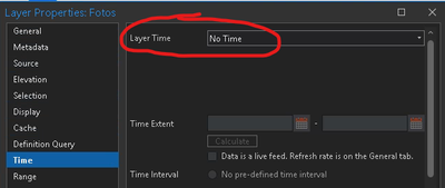

You can activate the time feature on layers. You seem to have done that (accidentally) for at least one of your layers.
To deactivate:
Go into the layer properties, switch to the Time tab, switch the Layer Time property to "No time". Do this for each layer.

I looked trough several projects, and I couldn't find which layer has time feature on, because for all layers time wasn't enabled. Maybe there is another way to turn this feature off?
