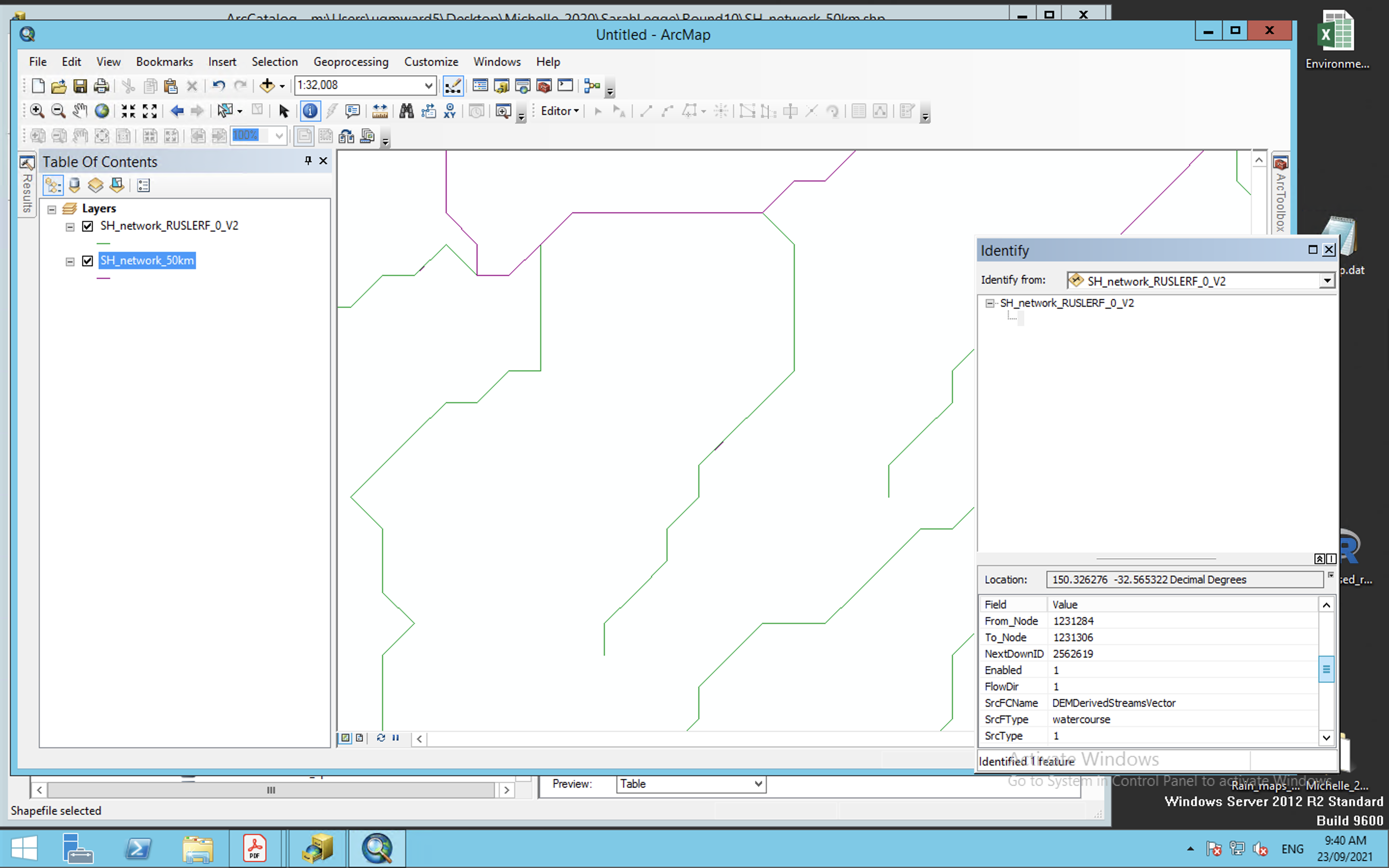

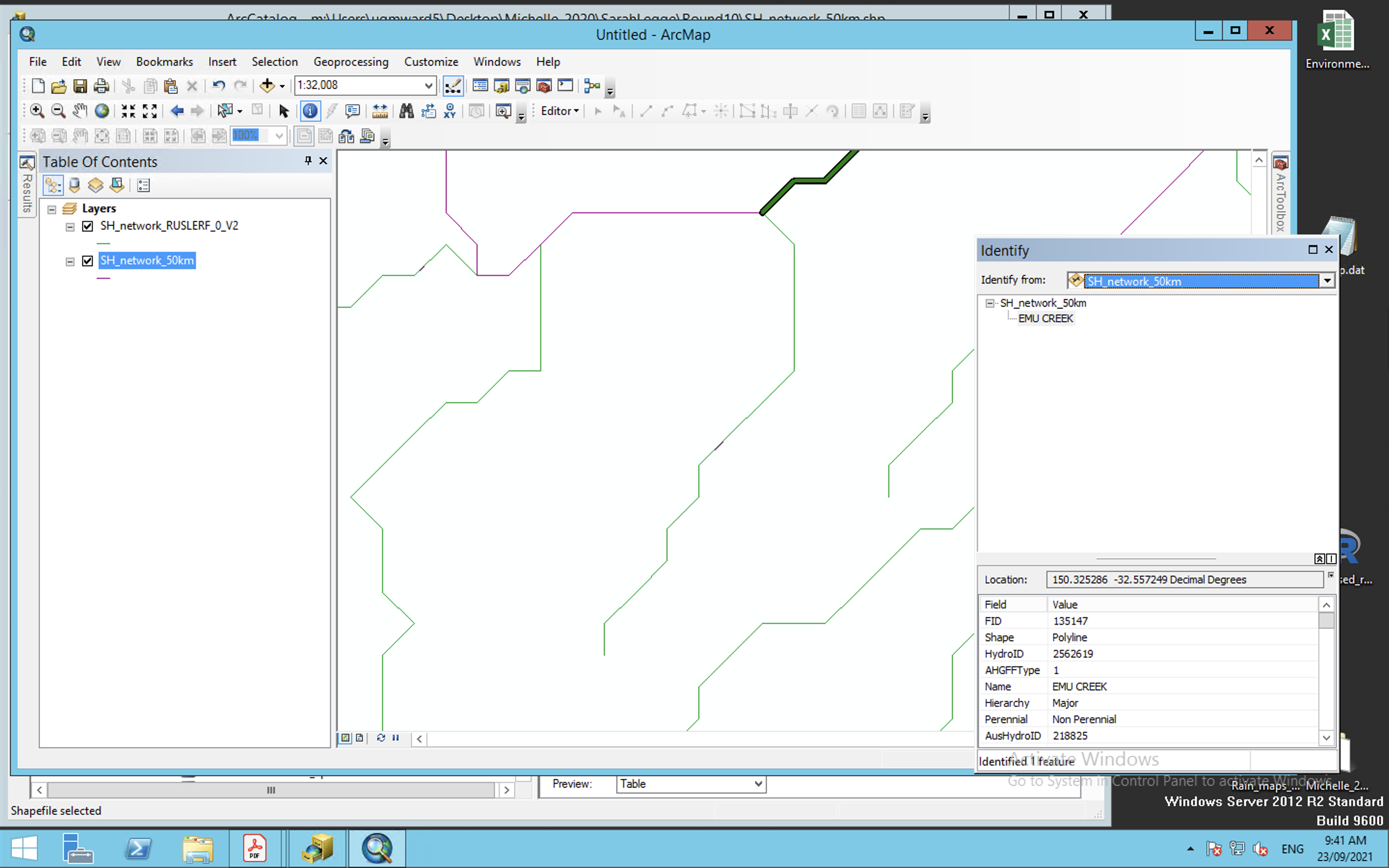

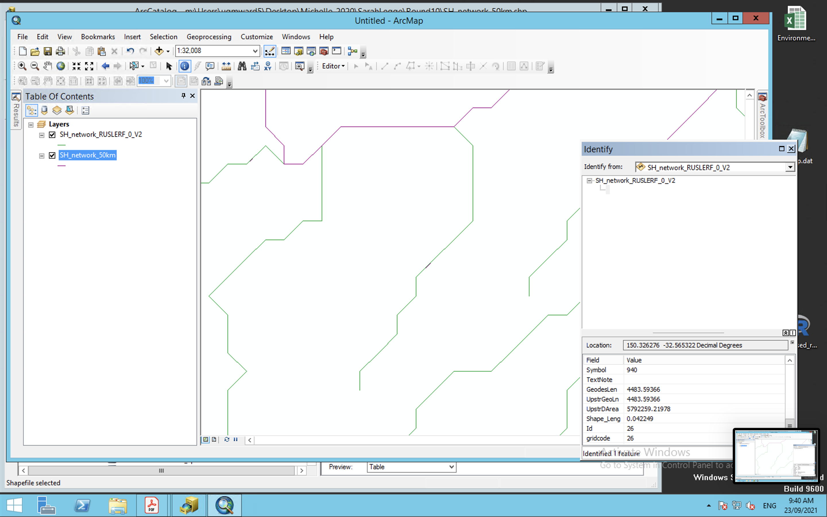

So in this below screenshot, we can see that this segment (HydroID: 2564302) has a grid code (sedimentation risk) of 26. The next downstream segment is HydroID: 2562619.
Screen Shot 2021-09-23 at 9.40.31 am.png  Screen Shot 2021-09-23 at 9.40.52 am.png
So then I would like to assign this next downstream segment (and every downstream segment for 50km), 'sedimentation risk'  26.
