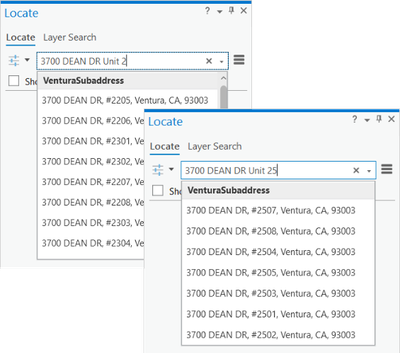

@BlakeTerhune ,
I created a locator in Pro 2.8.2 using data similar to what you have described and was able to search for a hyphenated unit successfully. I did not use the ADDRUNTTYP field in the screenshot below when building the locator. Are you not getting matches with the local locator or when it's published as a service or both?
