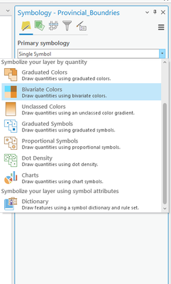

I can't find heat map symbology in the new version 3.1; how can I symbolize a layer with heap map?

NasratullahOmari
I have selected my layer, but in the symbology pane, primary symbology down arrow I can't find heat map.

ChristopherCounsell
MVP Frequent Contributor
Heat map symbology draws point features as a dynamic, representative surface of relative density.
You have selected a polygon layer. It's not possible to create a heat map from a polygon layer.
You can choose a different method - such as an attribute (population) to symbolize the boundaries?
