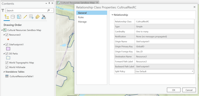

Hello. I am working on a Survey123 project for my local Park Service. We want to collect information about state historic resources. the data structure is a Site polygon layer, with a related point layer that shows the location of various buildings on the site. There is a lot of data already existing, and I want to build a new survey based on the data.
I am trying to relate the layers in ArcGIS Pro 2.9.1. I am following the instructions in this article "How To: Set up related tables for use in ArcGIS Collector or ArcGIS Field Maps (https://support.esri.com/en/technical-article/000015422)
I think I have followed the instructions exactly, but the relationship class doesn't seem to work. I thought setting up the relationship class should automatically assign the GlobalID from Sites to the GUID in Resources, but the GUID remains <null> and there is no relationship between the tables. I tried the procedure using both the point layer and the destination table and using a standalone table created from the point layer.
The common field between the two tables is Site_CRS, but I don't see how to use that information in the relationship class tool. I'm not sure what to try next.

You're on the right track, the Create relationship tool is the one you need. If Site_CRS is the common field, that is the one that should be used for the Origin Primary Key and Destination Primary Key fields.
If you want to use GUIDs instead, you need to create these yourself and make sure they match between the tables (you could join the sites to the point features and use field calculator to calculate the correct GUIDs).

LYELLCS
Thank-you HuubZwart, your explanation was very helpful. It took me a little while to figure out how to populate the GUID field using joins and calculated field, but once I got that right I was able to create the relationship class, publish to ArcGIS On-Line, and create a survey using Survey123 Connect which properly handled the relationship. Success is sweet!

It took me a long time to make this work, so I will share my step by step process. Apologies if it is too simplistic. Note my application wanted to create a one to many relationship between Sites and the Resources located within the sites. My steps refer to the names I created, but you can call your fields whatever makes sense to you.
1. Add the layers to your map. If necessary, use the copy features tool to create editable layers in the .gdb
2. Create a new field in Sites attribute table (your Origin layer) called TempGlobalID (field type TEXT)
3. Calculate the value: TempGlobalID = GlobalID (of Sites)
4. Create a new field in Resources attribute table (your Destination layer)  called Site_GUID (field type GUID)
5.Use the Join tool to add TempGlobalID to the Resources layer, using the linking field SiteID (in your case FacilityID) as the join field. [Note: At this stage I tried repeatedly to perform the calculation in step 6, but it didn't work. Not sure if the problem is my computer set up, or a real bug, but when I saved the map, exited completely from ArcGIS Pro and re-opened the map it worked.]
6. Calculate field value: Site_GUID = TempGlobalID
7. Clean up the data: Delete unneeded fields such as TempGlobalID and remove the join.
8. Create new relationship class as outlined in HuubZwart's excellent post above.
Good Luck!
