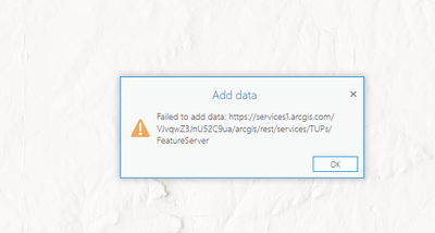

I have loaded ArcPro on a new computer with Windows 11 and I am unable to add data from the portal or living atlas.  I get the following error window.

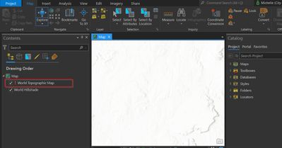

I also get the warning exclamation mark by the basemap in the contents pane.

So when I try to bring open most of the esri basemaps I get this in my Contents pane.  You can see that the link to the basemap is broken, as shown in the red highlighted box.

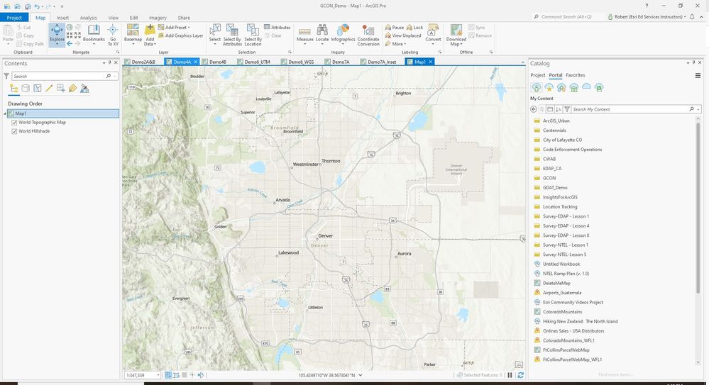

Interesting.  Below is my ArcGIS Pro with the World Topographic Map basemap available.  Are you using ArcGIS Online or ArcGIS Enterprise?  It also "may" be related to this maybe?

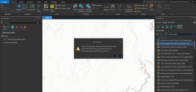

I tried adding the United States ZIP Code Boundaries 2020 features service and this is what happened.
MichelleMount
I will add that it is slow in responding and seems to time out.
