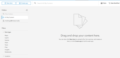

For exercise 1.5 in ArcGIS Pro 2.8 tutorial, I am able to share the map after fixing a couple of error messages that pop up.  However, when I go to ArcGIS Online under my contents, there is no map published.  Is there some privilege that I need to be able to do this exercise?
I log in to ArcGIS using my login provided by my institution (this is who grants me a license for ArcGIS Pro).

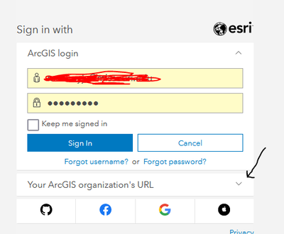

So the solution to getting access to ArcGIS online when using an institution provided license (as a single user)  was to add the portal that contained the institutions name  It is
and then you get the box to type in the organization's url:   xxx.maps.arcgis.com/home/index.html  (you put your institution's name for the xxx).  It is then linked to the institutional access which has many more bells and whistles than the public account.  Even though I launched ArcGIS Pro using my institutional account and added a portal with the xxx.maps, I was getting an error message (not recognized) when I tried to make the xxx.maps my main portal.  However, as soon as I entered the institution's name (provided by our administrator), it worked perfectly.  I selected the portal and it recognized me and I set this one as default (.... on the right side gives you the option to select it as the default portal).

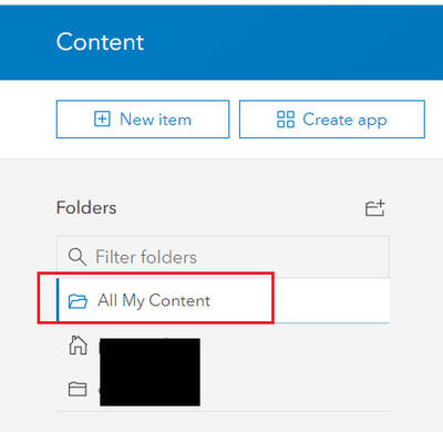

Also check if you have published to the Root folder or any other folder under My Content of ArcGIS Online.
In case you are accessing the My Content folder from Catalog pane, try to refresh the folder as well.

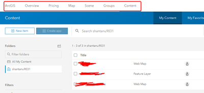

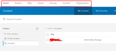

I need you to confirm something for me so that we can try and narrow down the issue. Basically, what I am wanting to know if you can see
A.
 (if you see this that means you are using a Personal ArcGIS Online account)
OR
B.
(if you see this that means you are using a ArcGIS Online Organizational account)
The reason I ask for this is cause if this is a public account then you might not be able to publish datasets to the account
You may refer the Esri document
https://esri-es.github.io/awesome-arcgis/arcgis/account-types/#arcgis-online-organization-account-ar...
In addition to this, if your account is indeed an ArcGIS Organizational account you can see your Organizational account's subscription ID and status of the account by simply clicking to the Organization tab, this is another way to confirm if your account is a public one or not. A public account will not have a subscription ID.
