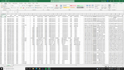

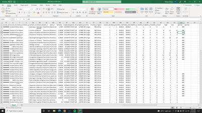

wb4062a
Here they are! Let me know if there is anything else you want to see, thank you so much for your help!
