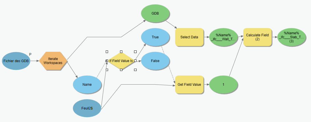

I'm trying to make a modelbuilder with thoses steps :
1) get a geodatabase in a folder
2) get a specific table in this geodatabase
3) get a field value from an other table (with a test condition)
5) calculate a new field with calculate field (it's a text field), and fill it with the get value function

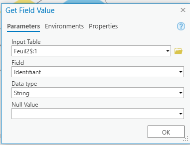

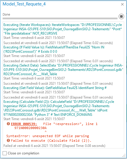

when I select the data type " string" in the get field value, I have this error;

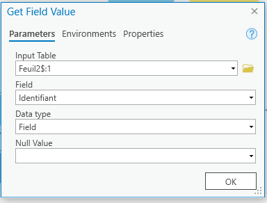

but when I select the data type " field",  in the get value, I dont have errors but the new field in my table is empty.

The Get Field GP tool only returns the first row according to the ESRI documentation (Get Field Value (ModelBuilder)—ArcGIS Pro | Documentation). If you are trying to copy a field value from one table to another I believe you need a common ID field to join the tables together before you perform the field calculation.
