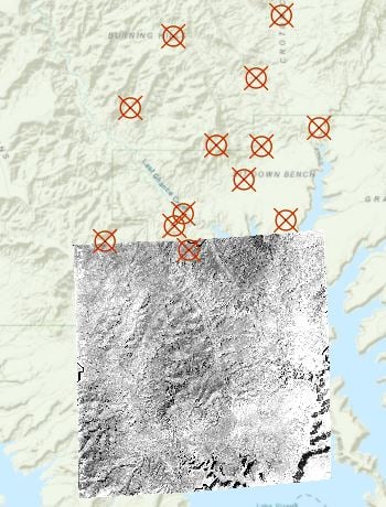

When georeferencing in Pro 2 using control points, my images are shifting downward once I save the results. After removing and re-adding the image, and loading the control points, the control points are being displayed in the correct locations but the image is still shown as shifted downward. Even when opening in ArcMap, the image appears in the wrong place. I am using the same coordinate system as the map when georeferencing. What could be causing this?

It think you're hitting bug BUG-000103090, originally reported with Pro 2, then I reported it for ArcMap 10.5. It was supposedly fixed in Pro 2.1.2, but we are seeing the same problem intermittantly. The problem is only with tifs, so convert your files to jpg before trying to georeference them. If you have previously georeferenced tifs, use the Raster to Another Format tool to convert it to something other than tif.
Update, using Pro 2.1.2: it is also happening with jpgs now. Also, sometimes the image just disappears when you save georeferencing then close georef mode. Start georef mode again, and the raster reappears. The same raster will display in ArcMap 10.6.  And yet another: sometimes you click to add a control point, but the cursor never changes and you can't add a point.
All of these problems happen whether you have the Pro options set to use world files or not. We've resorted to georeferencing with 10.6. So far, ArcMap is working for us. Clearly, the bug that I was told is the cause doesn't explain all of the problems that we're seeing.
