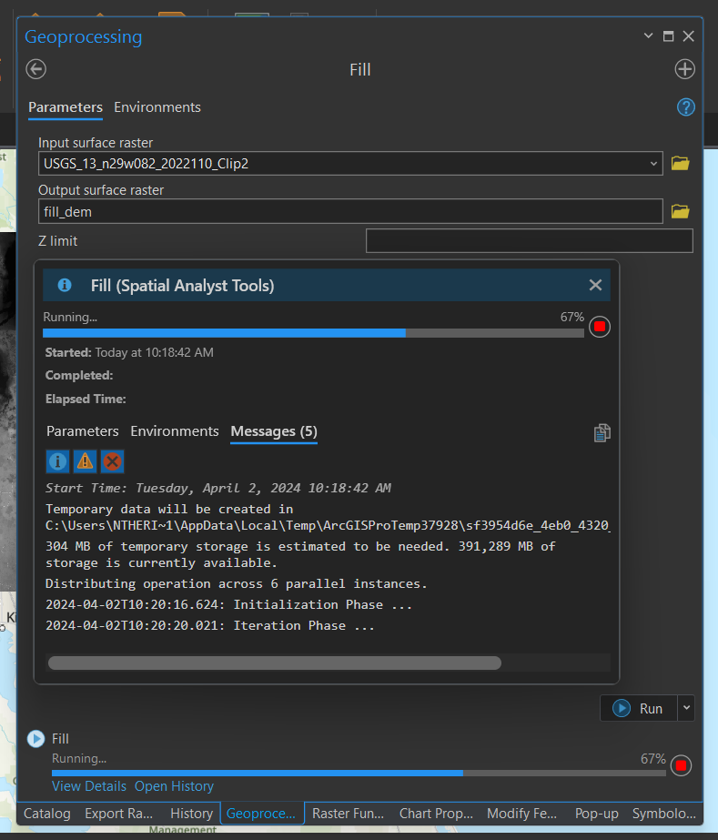

I'm trying to use the Fill tool and it keeps getting stuck in the middle of the process and never finishes. Its gotten stuck as several different percentages (50, 56, 67, 88, 98, etc). I used this tool with no issue about a week ago, but since Friday I haven't successfully run the tool.
I can clip rasters without issue, but I had this same issue using the Nibble tool.
I've tried: using the tool in multiple different project files, clearing my cache, changing the output location, downgrading from ArcGIS pro 3.2 to 3.1, trying different DEM's. Still, the process does not finish.
I have an advanced license; spatial analysist is active. I'm currently running ArcGIS Pro 3.1.3.
