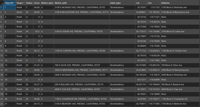

@ShanaBritt Correct, I do have the addresses as "700 Block E Olive Ave" for example.  Those will geocode to the centerline, but if there is no address (null) the locator does not resort to plotting the lat/lon of the data:
See below:
I can create an event layer just fine with this test layer.

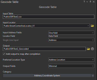

Also, my geocoding settings:
