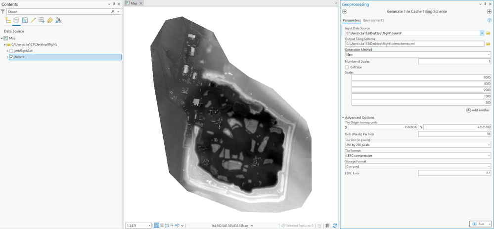

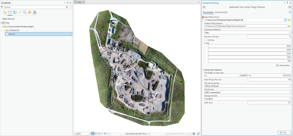

In the images below, you can see how it gives the error on the image file, but there is no error when i choose the dem file. Both are .tif files. Thank you.
Blevins_Mark
I think it was because i had the tile format set to LERC for the image, which i dont think is compatible with an image. Changing to one of the other formats gets rid of the error. Sorry, my oversight. Thanks.

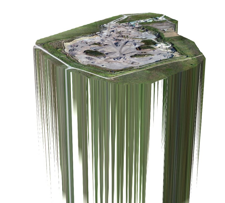

@GordonSumerling actually do you know how i can get the image to not "extrude" the edges? Thanks.
Blevins_Mark
@GordonSumerling nevermind i found this and making the footprint of the image a bit smaller than the ground layer resolved the issue. thanks.
