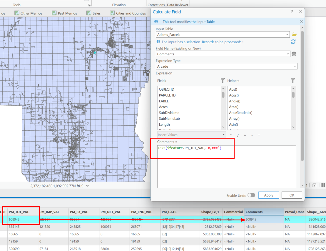

Here is an example of me attempting to run this calculation on a hosted feature service in ArcGIS Pro - as you can see the Comments field shows the exact same text string without the additional formatting of the thousands separator.

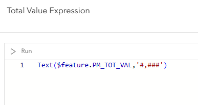

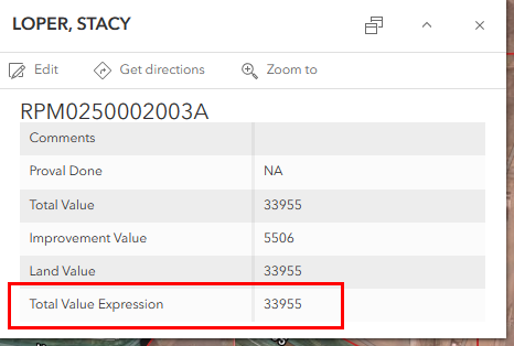

Here are my attempts at running this same expression in Map Viewer field expressions and the result which still does not have the thousands separator or a dollar sign:

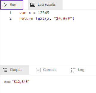

Your PM_TOT_VAL looks like a text field. Throw a Number() in there:

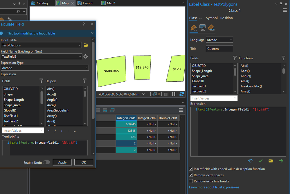

var x = "12345"
return Text(Number(x), "$#,###")

KaraUtter2
Hi @JohannesLindner, my PM_TOT_VAL has numbers in the fields - please look again. They are all numbers. Also, I don't see the result in your photo of ArcPro that shows that the commas were added appropriately to reflect thousands? So, I still don't see that it's working the way that it should.
