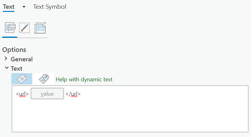

Further, setting the <url> tag before the dynamic element in the text properties makes this URL clickable on PDF export like so:
So far so good!
