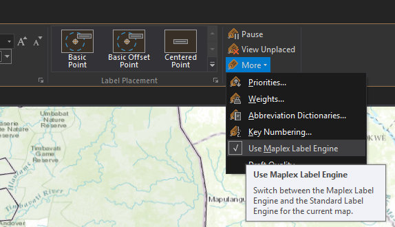

A less elegant option (without code) would be to simply change the label engine from Maplex to Standard Label Engine by un-selecting the Use Maplex Label Engine under the more options.
This should ensure all labels are on one line.

I turned off Maplex Label Engine and added \n before my parenthesis to push this portion onto to the second line. [full_name] + "\n (Z:" & [zone] & " R:" & [rank_id] &")"
There must be a way to format this in Maplex, but using a line break was creating too large of a break for my desired label appearance. For now, the less elegant option does the job.

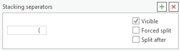

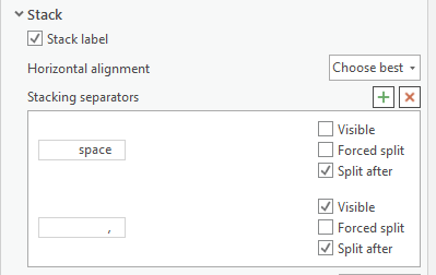

This problem may no longer be relevant for you, but just in case it is: the issue is that maplex has the option to specify stacking characters, and the space character is a stacking separator by default, so it splits on any space it sees fit.
You could remove the space as a stacking separator and choose an open bracket character for example, with visibility on and split after checked off.
However, this won't help you if you still want it to stack on space characters in other parts of your expression. For that, you can use non-breaking space characters.
You can replace regular spaces in part of your expression with non-breaking space character (U+00A0). For example:

Or as a third option, you can hard code your new line character, and disabling stacking as a fitting strategy
$feature.full_name + TextFormatting.Newline + "(Z:" + $feature.zone + " R:"+ $feature.rank_id +")"‍‍‍‍‍‍
All the examples above are using Arcade, but will work just as well in any other parser. For VBScript make sure you use + vbnewline + instead of TextFormatting.Newline to ensure you have the correct type of line feed character.

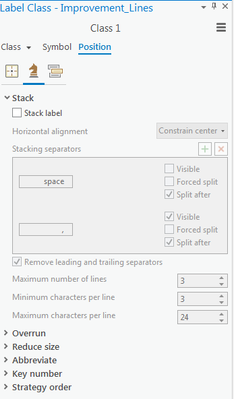

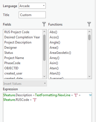

Hi @CiaraRowland-Simms , if I disable stacking my label does not use the TextFormatting.Newline? Maybe a bug? I'm using Pro 2.9.3.

Hi @Anonymous User,
Would you be able to send over what placement strategy you have on this label?  Or send the layer file for me to take a look? Some types such as street labeling and contour deliberately ignore any new lines in the expression, so I'm wondering if you might be using one of those.

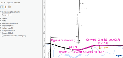

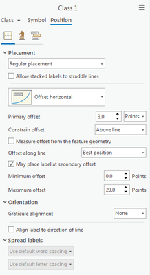

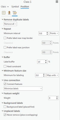

Hi @CiaraRowland-Simms, here are the screenshots of the label position tabs.
Let me know if that helps.
Thank you!
CiaraRowland-Simms
Hi @Anonymous User ,
Thanks that's great! My suspicion based on those properties is that Never remove (place overlapping) on the Conflict Resolution tab is causing the issue. That property is really a last resort to get text on the map when there isn't enough room. Would you be able to see if turning it off resolves your stacking issue?
Ciara
by Anonymous User
Not applicable
Hi @CiaraRowland-Simms , no that didn't change it. It works for some of the labels but not this one.
