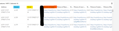

Hey! Super excited that this would work out. Attaching two little pieces of information that I think could help determine if this could work.
1) here is what information from our dataset looks like (this is from AGOL, but we have this in pro, too)
This would work as anticipated because there is a address (street) and house number, correct? There is also a full address field.
2) an X'd out version of a URL we are working with. This should also work because there is a .jpg at the end, correct?
https://mydoforms.XXXXXXX.com/imageViewer?blobKey=ag9zfm15ZG9mb3Jtcy1ocmRyFwsSCmJsb2Jfc3RvcmUYgIDY77KJggoM&blobName=XXXXXXXXXXXXXX$$10042018122407$$Published$$1756$$P1$$1.jpg

2) Semi-follow up to question 1, as you can see, I have MANY fields with image URLS. Can I do all pictures for a specific address at one time so they will all be sorted into the same folder and then named with the field alias?
i.e. here is a better picture of our dataset, tons of URLS with images. (there is more than what is pictured with URLS
I also attached a sample of how I was hoping to develop the folder structure.
Essentially, would i have to run the script multiple times for each field with a URL? Or can this script (somehow) be utilized so that each record tied to an address downloads all related URL fields/pictures at once?
Sorry for so many questions! I will be happy to test things out and report on how they worked out, I just need to understand more of how I can get there 🙂
